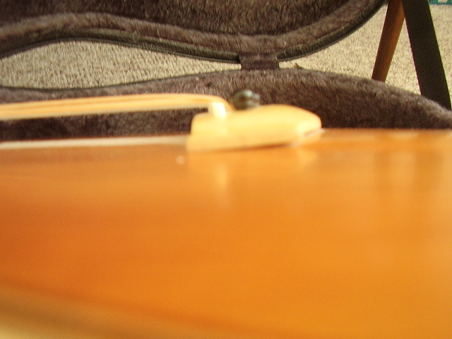

PostPosted: Mon Apr 02, 2007 9:10 am
From the sounds of your discription, this same thing happened on my first guitar.
take a look
There is a noticeable ridge where the x-brace crosses under the bridge wing.

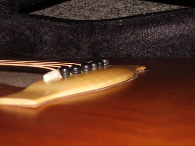

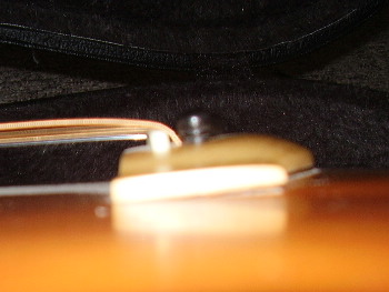

another couple of pictures for you
You can kind of see the ridge in this first picture.
This is all due, in my opinion to the top being to thin and the bracing a bit to light.
The sound on this guitar was really really nice, but alas, It's out of commission now because of the to lightly braced and thin top.
PostPosted: Mon Apr 02, 2007 9:13 am
The bridge on mine was (as you can see) really going to pull off. I think I could pull it off and glue it back down but that wouldn't help with the ridge or the extreme belly in the bridge area.
By the way, this guitar started showing these signs after about 10 months old and progressed very quickly. I put it to rest after only 2-1/2 years old.

Thanks Rod - my guitar does look very similar to yours. Do you think inserting a spruce brace between the X braces parallel to the bridge just off the bridgeplate will help?
PostPosted: Mon Apr 02, 2007 9:57 am
Yes I think that would help. Make it higher than it is wide of course and higher at the middle than at the ends where it will but up to the x-brace.
This will be a bit hard to get a perfect fit of course as well as the arc (if you made the top with an arc) matching the other braces as you probably braced the plate in a raduis dish or something similar. Some long cam clamps will get the piece in there I'm sure.
don't know what this will do for the ridge thought, hopfully it will take care of it. But it should take care of the bellying.
Maybe some others will add their wisdom as mine is very very limited.
PostPosted: Mon Apr 02, 2007 10:29 am
rod, i'm unfortunately not able to discern the ridge you refer to in your photos. though i've never used one, according to the makers spiel this would appear to be one type of situation where a bridge dr. might be beneficial. have you thought about trying one? i would be interested in hearing about the results if you decide to try it.
also interested in what sort of glue you used on the bridge since it started to fail so quickly. any ideas as to what caused that?
also, do you have any specs on the top and the bracing?
PostPosted: Mon Apr 02, 2007 10:32 am
I would suggest a JLD bridge doctor for something that bellied .. not sure what else save retopping or at least rebracing if you removed the back would do ...
